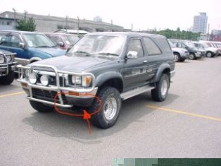

    Well, I was driving home through one our sussex forest last night when three deer came bounding out in front of me. I was travelling at a reasonable pace so the deer had no chance. It hit the left hand side of the front and then went under the wheel, so the surf was all over the place, and it took several heart pounding seconds to regain its composure. The deer I believe was a right off.
    I now have the left front wheel tracking out and worst of all the piece of bodywork in front of the wheel is bent completly out of shape. Does anyone know what that is called so i can order a new one?
    I have attached a photo (not of the dent) with the offending area circled.
    Ive attached a photo (not of the dent)
      I think it is called a Bumper Skirt.
      Neville
        It's the Front Valance Panel. Toyota Part Number for '89-91 Surfs is 53911-89119 & the retail price is £67.80 +VAT Milner's equivalent is just as good and costs £22.50 +

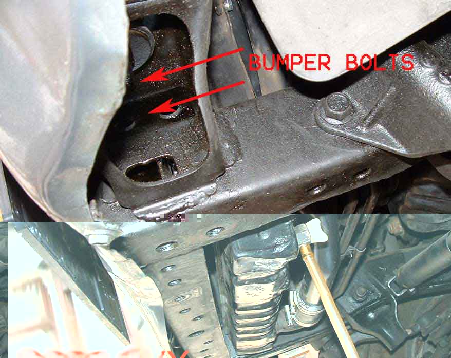

        It's a lot easier to fit the valence if you take the whole bumper assembly off....
        Take the nut off the downward facing bolt under each bumper corner, remove the turn indicators and unplug them. Then remove the 2 bolts on the outside of each chassis rail and the whole front bumper will drop off.... takes about half an hour total time to remove the panel and fit a new one.

          If i order from milner 4x4 do i just specify one of the standard colours ie gun metal grey. or does it need spraying?

              All replacement panels come in black primer so you would need to either spray it yourself or pay a bodyshop to do it.
              The guy I use charges me 2 hours labor @ £27.50 + about £50 materials for a single valence but I usually have several done at once which works out much cheaper.
