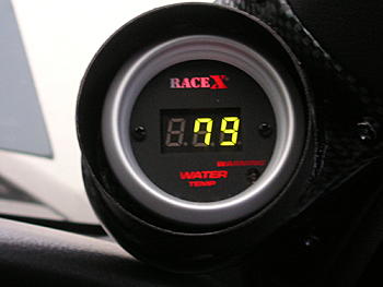

    Got around to fitting a digital temp gauge to give a more accurate reading of coolant temperture as the standard gauge doesn't move much and so I don't trust it.
    Had to make a piece to take the sender unit though which I was hoping to avoid,however after a bit of manipulation it fitted into place and so far is working ok.
    It is reassuring to see an accurate display of water temp. that you can see rise when engine working harder and then see temp. drop when engine under less load again - whilst the standard gauge doesn't appear to move past just under half way when running.

    Looks good . Very nice fitment .

        The pipe is 38mm/1"1/2 outside diametre and the thread size is 10mm with 1mm pitch.The pipe I used is a 90 degree elbow cut back and welded with a sleeve each end (approx. 45 degrees).
        The gauge is from speeding.co.uk (the only place anywhere I could find a digital temp. gauge) costing £48 incl. tax + del.

                I bought one of their pods meant for on dash instalation but it didn't fit neatly so I trimmed it to screw to the drivers side pillar.I know they sell pods for mounting on the pillar so think that may have been a better option.Also I had to make a shroud (out of a spray can lid!) to shield from the light as L.E.D. display harder to read in strong light.
