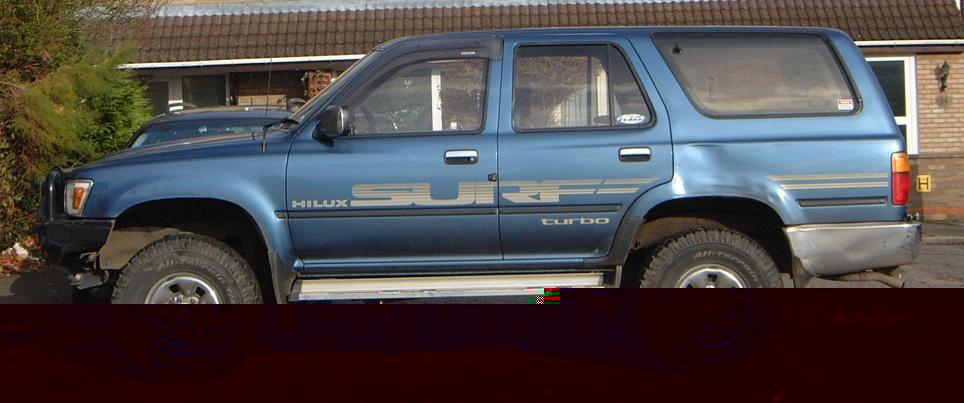

    LA Super Trux 2" rear lift + 2" torsion bar crank up. 31" tyres.
    Side steps removed....

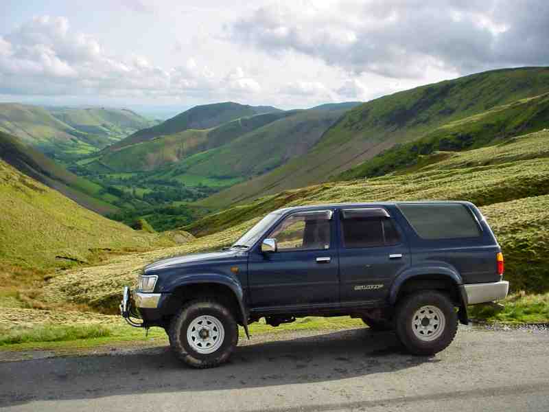

      "Rich lifted the rear with new springs and shocks, did u touch the front torsions or not"
      No, I just set them to approx 14 inches from the inside of the wheel arch to the wheel rim
      All my pics are here:
      http://www.afm15.dial.pipex.com/surf...cs%20index.htm
      The best pics are the Beaulieu ones as I had the Procomps fitted. The old shocks were cattle trucked.

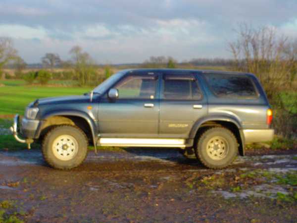

        Looks a bit like this
        Roger

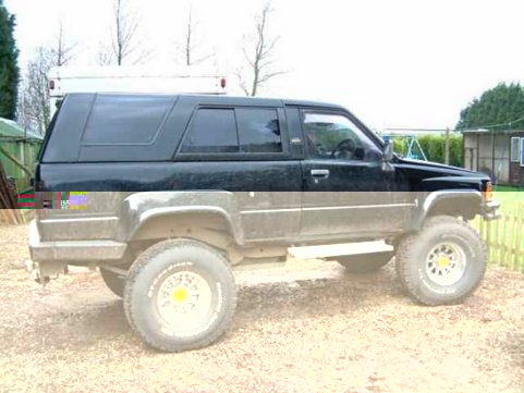

          ride side on
          1st gen 3" bodylift
