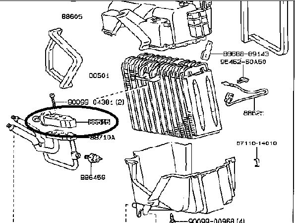

    My aircon man can't find a listing for the expansion valve on the surf - does anyone know what the part number is for the expansion valve on the3.0TD 2nd Gen (KZN 130)??

        Not sure of the bit your looking for, but checked EPC for expansion valve and it shows the one highlighted below.
        If thats the one its also found on 93 on corollas, hiaces, land cruisers & surfs, and many others..
        Toyota P/N 88515-20100
