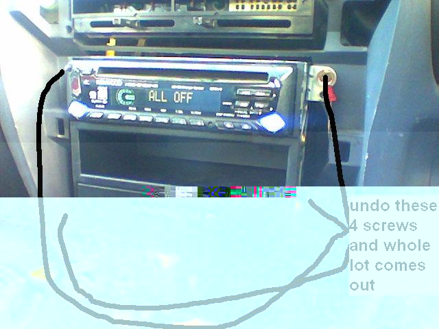

    I used the existing arms that bolted to the radio and cd unit, put in the new radio cage and soldered it to the arms and then bolted the universal pocket underneath. Slid in the radio then put dash back. Radio ain't coming out unless the whole dash is taken off first.

      I fitted a single din unit in my Surf without cutting. The knack is to mount it from behind the dash rather than through the hole. With luck your unit should then be able to be bolted in place.
      With mine the front trim came off and fits neatly over the unit and the dash.

        the ashtray assembly comes out and this has a plate either side with ickle bitts sticking out that correspond to the holes in the side of the stereo pop it in there clamp together put back together and berts my uncle

          Best off bolting the radio in from the sides as per the original Din mounts, secure no vibrations, looks neat, no need to cut plastic, easy to do, no worrys. Need a hand ? give me a shout, I'm only 10 mins away from ya and its about time I met up with someone else here anyway (only met Ciaran/Cmar before)
