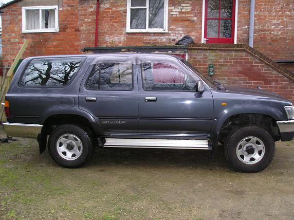

Lifts, modifications etc. all now completed, big 33" MT tyres now fitted too!
Here's a list of mods I've done so far:
1) 2" Pro Comp Explorer suspension lift (ES3000 shocks, 27mm torsion bars, 2" longer rear coils).
2) 2" 4Crawler rear coil spring spacers
3) Extended braided, stainless steel rear axle brake line.
4) 2" body lift with 40% stronger stainless steel mounting bolts & UHMW body lift blocks (made locally!).
5) 2" bumper lift brackets & 2" radiator drop brackets fitted.
6) Steering column extended and firewall steering column hole enlarged.
7) 33" x 15 x 12.5 General Grabber Mud Terrain tyres fitted including spare.
8) Extended panhard rod bracket fitted.
9) Set of MUD CLUB and HILUXSURF club stickers added!
Fairly pleased with how it handles on-road even though it's now 7" higher than stock (it's about as wallowy as a standard Discovery now!). First offroad trials coming up this weekend.
