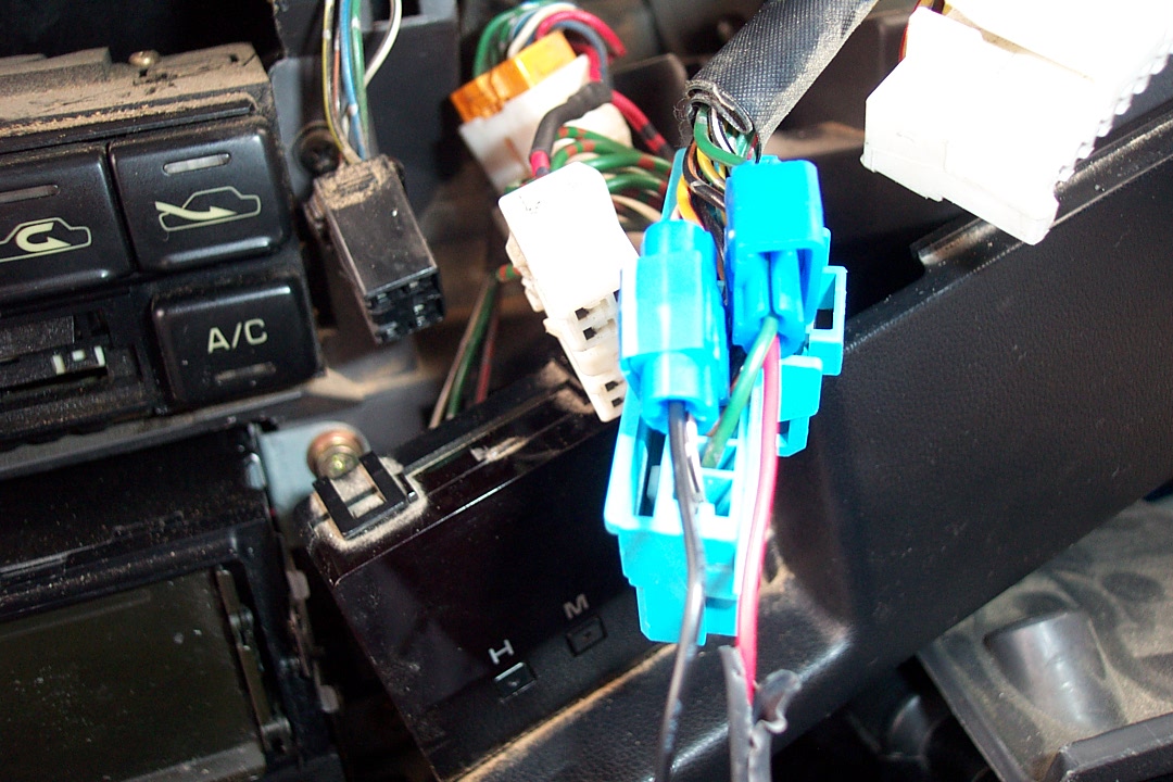

    OK, I'm done - I fitted my white dials today but I have a problem... they don't work
    They were easy enough to put in but I simply can't get them to work with the illuminations.
    I've tried wiring them in off one of the dash switches and earthing them directly to a bolt, and currently they are wired in to the positive illumination and the earth of the stereo but for some reason they just won't light up.....and I just don't get it I've been out there for hours...
    I don't know what else to check, they are assembled properly, all the connections are good, the stereo works, I can only think they are faulty Not sure if this is really a rant or a cry for help?!
    If anyone has any suggestions as to what could be wrong then I'm definately all ears!

    Maybe this helps - colours should be the same although you have a 3.0.
    As far as I remember the two wires are from the left most plug behind the dash if you look at it.
    Green/white band for positive and white/black band for earth (these are the two leftmost wires on the block).

          Cheers, was gonna call but looking at the problem it's like there's only two wires, how it could go wrong?!!! I figured it must be a bad connection or they are faulty but then it was around 10pm so I thought I'd leave it until the morning...
          Real trucks don't have spark plugs
            Doug, check you have a good connection to +12V and earth. Try taking a perm feed and earth straight off the battery to test the unit works.
            If it does then make sure you have the correct illumination wire feeding the new clocks. If you are using scotch block type connectors the bin them and use crimps

              Oh dear - I found the culprit... a schoolboy error on my part for not checking but for some reason the 10amp fuse for the dash illuminations had blown
              I was doing this yesterday without a decent voltmeter but my new purchase this morning has already paid for itself! They light up a charm now on the wiring I did last night - though the revcounter isn't working so need to push the face back a bit with some even wider spacers!
