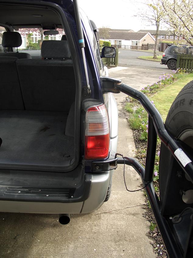

          Wonder if I need to remove the wheel
          After talking to the SVA guy, I've taken the following photo from the rear which shows that the lights are not obstructed when the wheel is swung out and the pin locks the wheel in place.
          I wonder if I need to remove it then?

            Right....got a definitive list when I went yesterday and can clear up a few points for any futures SVAers.....
            Rear wheel carrier has to come off. The hinge at the side protrudes too far from the body work.
            Take it off and fill the holes.
