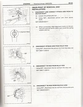

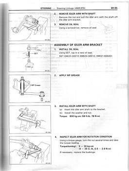

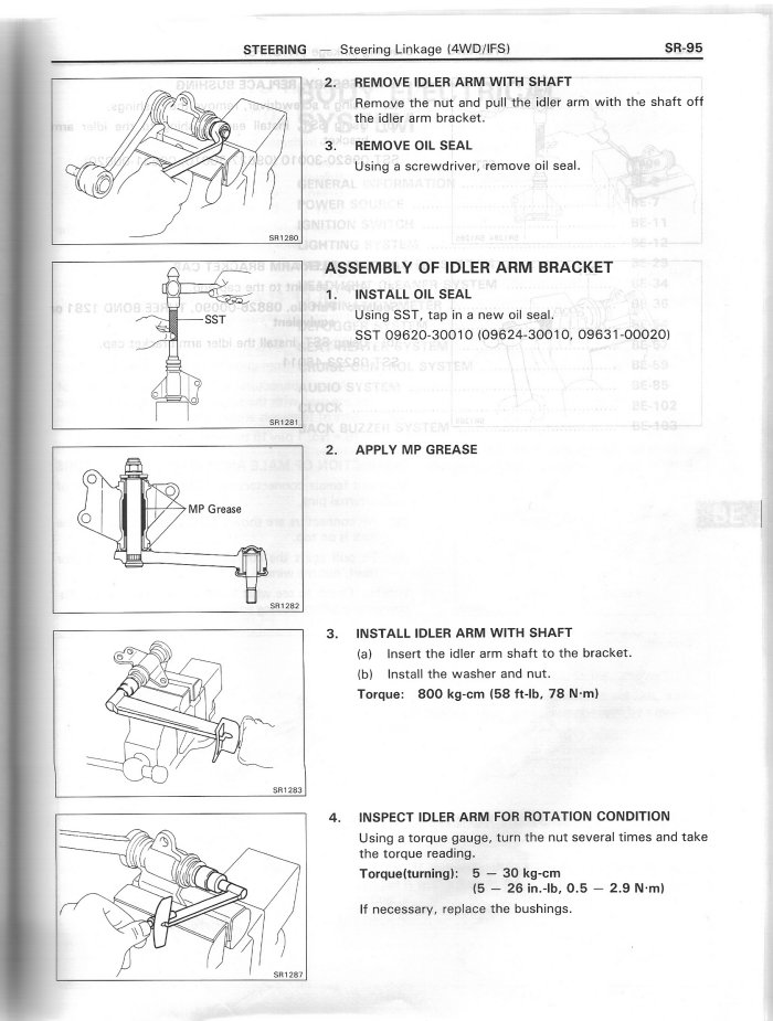

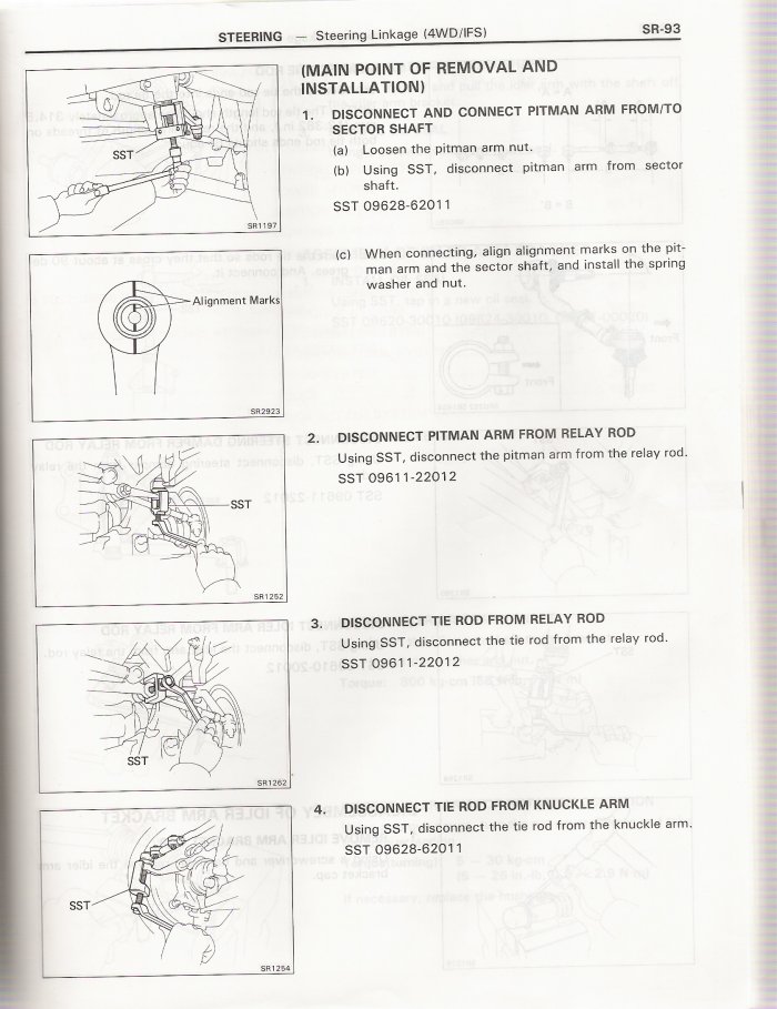

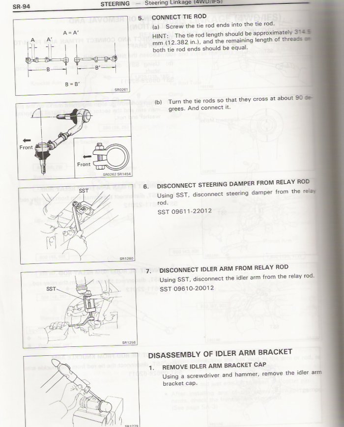

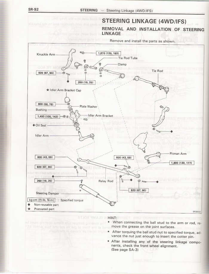

          Heres some pics for the time being HAYNES do a manual for the 4RUNNER as it uses the same running gear.

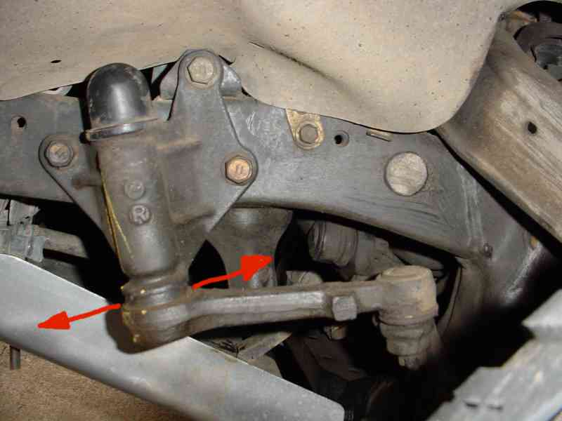

                  Yep- check for worn steering idler. Jack up the front passenger side till the wheel is just off the ground. Grab both sides of the tyre and try and move while watching the idler arm (see picture- it's bolted to the chassis just behind the tyre). If you see much movement of the shaft in the sleeve then it's probably worn. You'll need to either fit new plastic bushes or if the shaft is rusted (as they often seem to be) a new idler arm (~£60 from Milners).
                  Grab the top and bottom of the tyre next and see if this can be moved in and out. If there's more than 1 - 2mm movement the wheel bearings will need a little tightening (do this test both sides).
