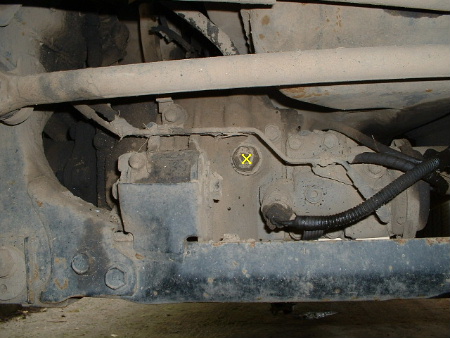

    I cannot find the refill port for the front diffential oil on my 3.0L '93 automatic and it's blue if that makes any difference. Despite the pictures available on this site. The good news is i didn't drain it first without checking.
    Prehapes someone can 'X' mark the spot?
    Thanks
    no probs, x marks the spot !

      I presume you removed the cover under the engine, otherwise your look different to mine!!!!
        Yes. i took the cover off and there it was. Thats my complete oil change Sorted. However, i have now seen that i have got a leak from my power steering fluid. That's tomorrows job.

            How are you supposed to get to that with the air con rad in the way...?
              Andy I'd swear my aircon rad sits in front of the main rad but I could be wrong, '91 SSR 2.4
                Mine is below... what a pain that is going to be... ought to do it this year...
