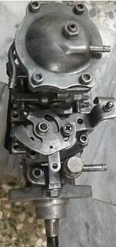

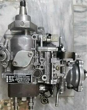

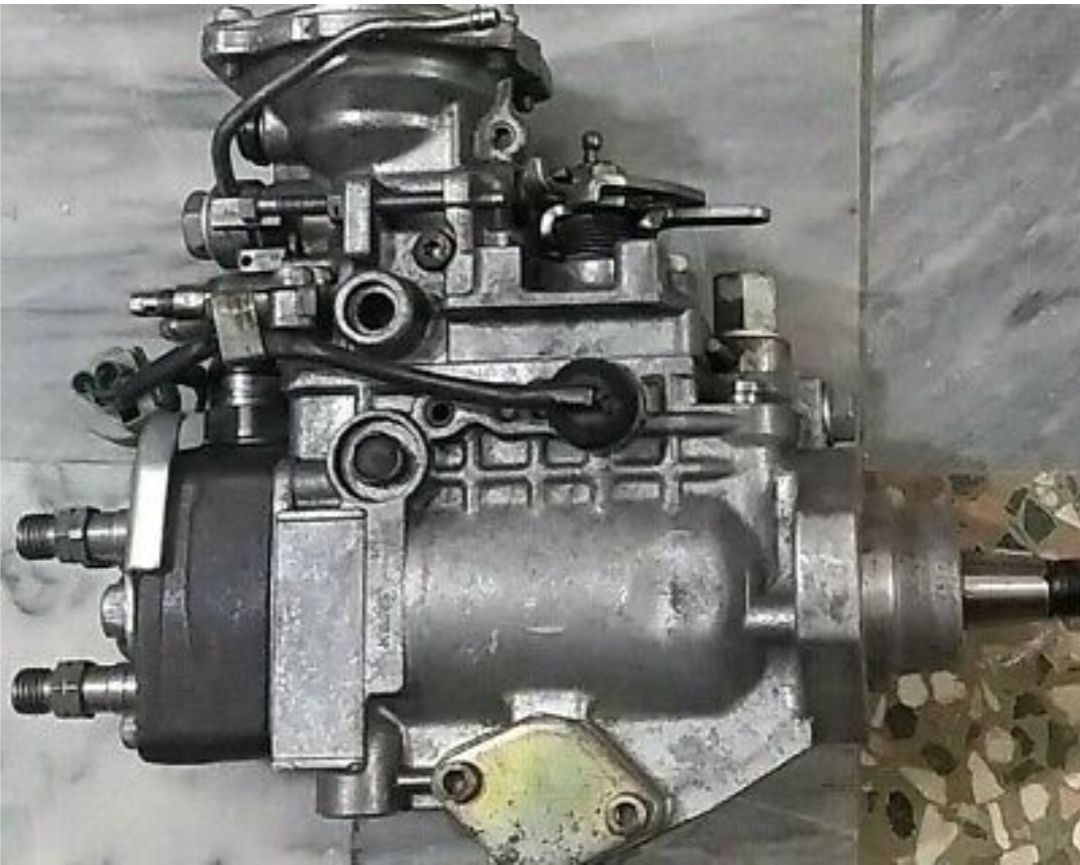

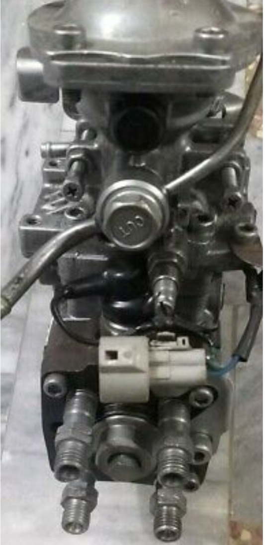

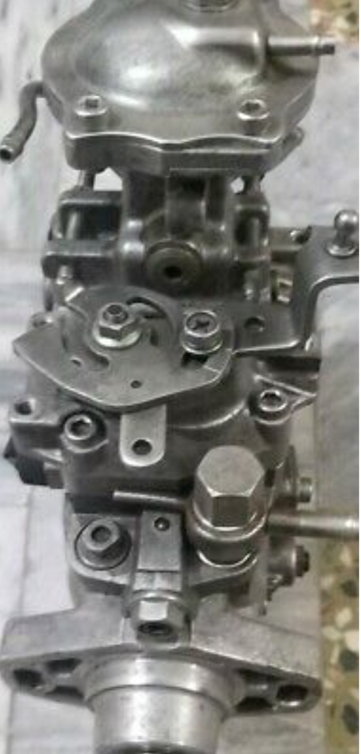

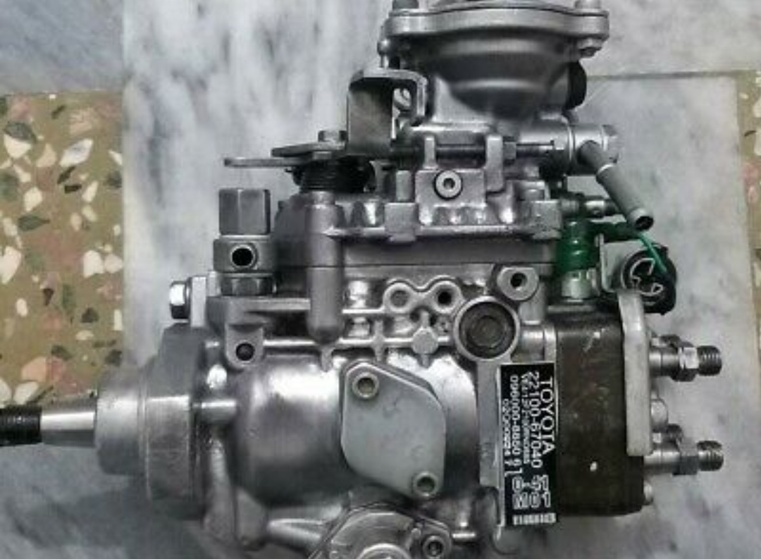

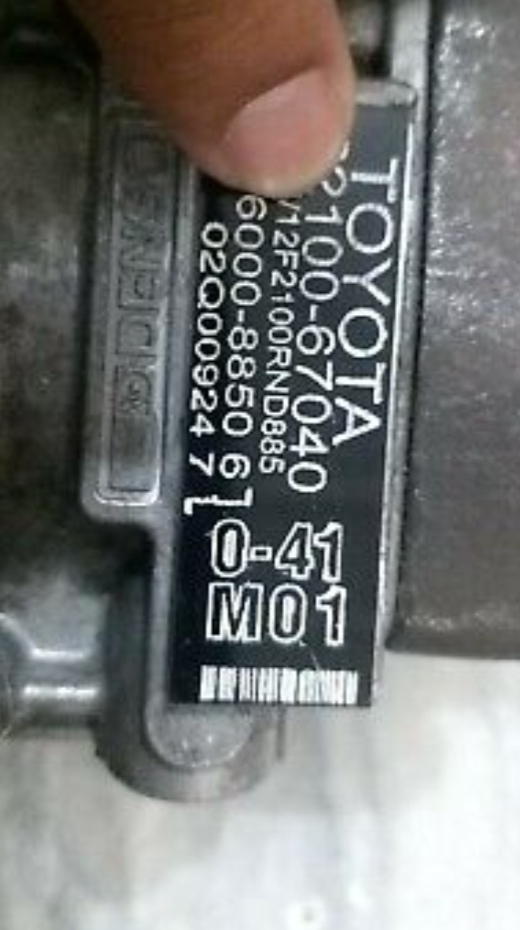

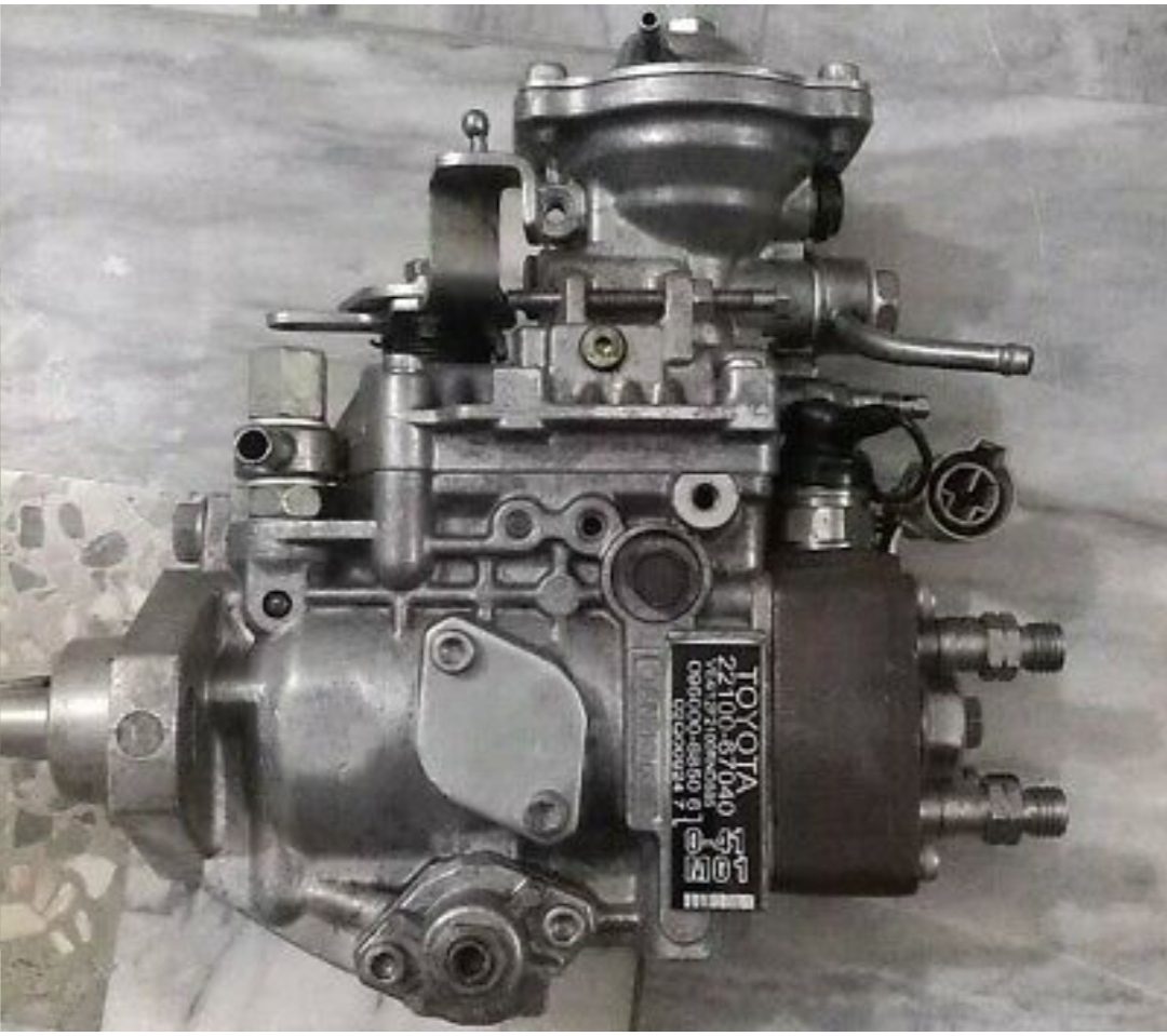

    I want to fit a manual pump on my kzn130 surf manual transmission.
    I got offered the one on the pictures, would you say that is the correct one?
    I believe I need to have made a wiring loom to tell the ecu all is ok. is that correct?
    also do I need something else?
    thanks
    Part 22100-67040 (PUMP ASSY, INJECTION OR SUPPLY) was found on the following models:
    Europe 08/1988-07/1997 TOYOTA HILUX RN1**,YN85,90,1**,LN85,90,1**, VZN130,KZN130 22-02: INJECTION PUMP ASSEMBLY

      I think manual pumps were only supplied in Europe.

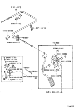

        Thank you very much, now I need to figure out how to open the diagrams to see if I need anything else like linkage,...
        I appreciate your help. Thanks again
          would that be the link ? i cant see a picture of whole installed
