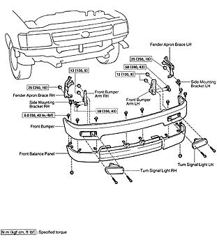

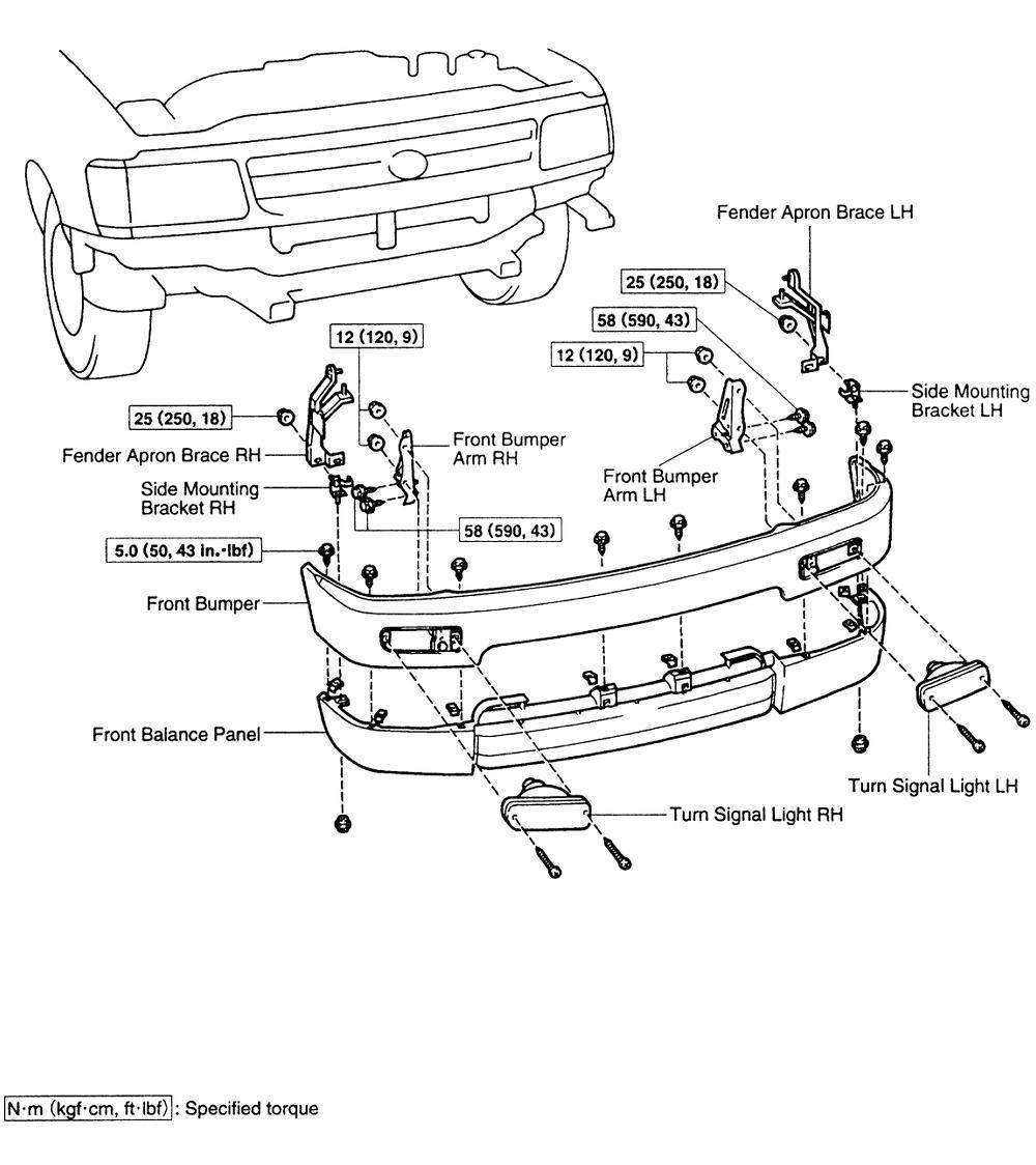

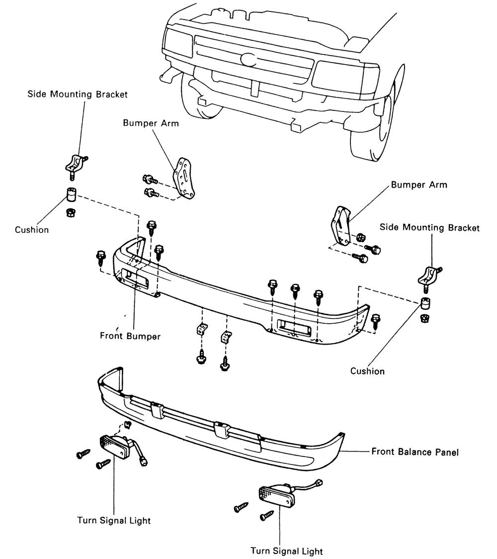

Hello, Just fitted some brand new BFG AT KO's (31-10.50-15) and they catch on the bottom edge of the valance. Without looking yet, is it easily removeable? I don't want to crank up the torsion bar just yet until I buy some taller rear springs.
