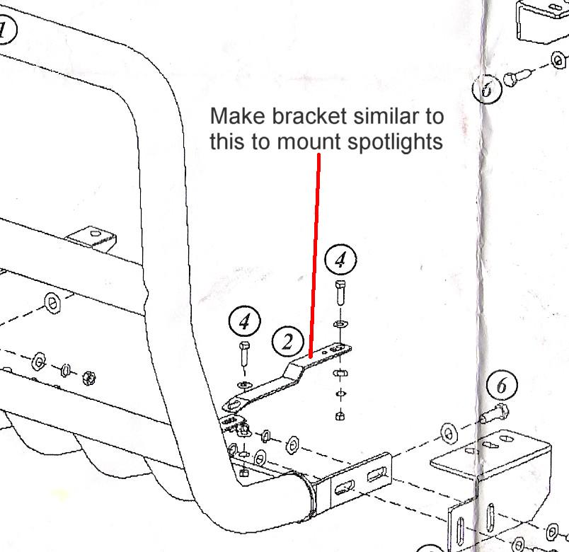

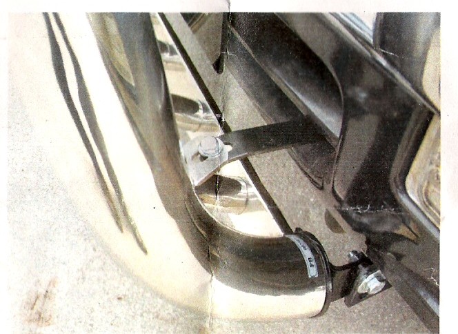

      If you look through the front lower valance you will see some holes on the front of the chassis level with the outer vents in the front valance. I recently fitted a different A-Bar to my Surf and it came with support brackets that utilise these existing holes in the chassis. I am sure it will be a relatively easy task to fab-up some brackets to carry your spotlights and fit them to the same holes.
      Have a look at the attachments they will show you where the holes are and roughly what type of brackets to make.
