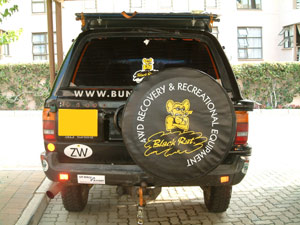

                i might be wrong but don't you have to take into account where the no.plate is situated with the reversing lights.the dealer i got my surf from wanted a rear mounted s/wheel carrier and he was told you cant get them because the no.plate is in the centre of the rear hatch and the carrier would cover it.
                  Yeah noticed that, but then I just assumed you get a different hatch.
                    what will you do about the reversing lights
                      Reversing lights shouldn't be affected, and you don't need a new rear door, you just remove the old plate and light unit, bolt on the carrier from your donour vehicle and get a square plate made up and rivet it into the gap to the left of the rear carrier. Only prob is if lighting the plate is still a legal requirement in the UK - it ain't here.

                              Unfortunately there is no cheap way of doing it, I am in the process of making a rear carrier now for my 4 runner so that I can move the spare from under the car. I looked into doing what bundubasher did and it just got very messy so I am going down the road of something like this:
                              spare carrier
                              I will probably mount the number plate on the new rear bumper and attach a number plate lamp from
                              vehicle-wiring-products
                              Just in the process of getting the brackets etc cut at the moment, then the tricky bit is working on the swinging arm bit so that its strong enough, if you want more info let me know.
