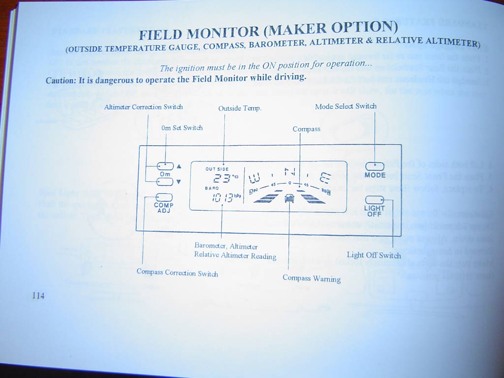

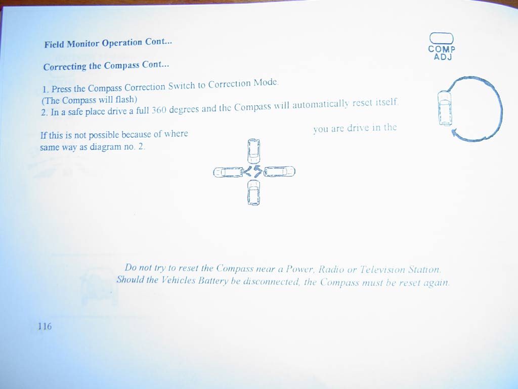

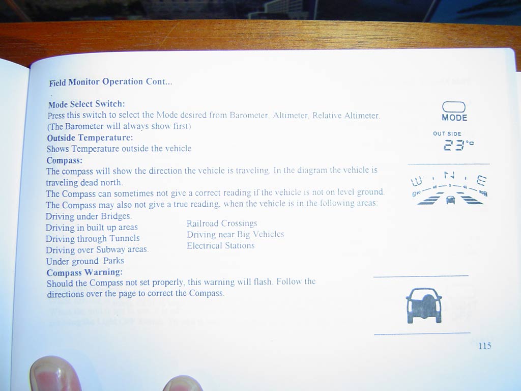

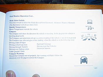

    Hi all,
    Just got home after buying my Surf and so far there is only one thing intriguing me.
    It's a '97 SSR-X and on the display where the compass is there is a mimic of a road (2 green lines) and yellow Surf which flashes sometimes for no (to me) obvious reason.
    Why does it sometimes flash and othere times stay on?

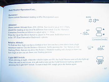

    The flashing means that it has lost it's bearings and needs to reset.
      Thanks for that Andy and also the thumbnails as I didn't get a handbook with the beast.
      Colin

            anyone know if this Field Monitor option is something that could be retro fitted?
            I've got a 96 3rd gen with very few options and that looks like a neat box to have!!

                Handbook
                Colin
                Hi Colin
                Glad you like the Surf!
                The drivers handbooks for the 3rd Gens are readily available on E-bay, which is where I got mine from. Full of all sorts of useful info, like the 3 position rear seat recliners and how to drop the front seats to make a couchette arrangement with the back seat!!!
                What more could you ask for?!!!
                Seriously though - it is handy to have a copy!
                Keith
