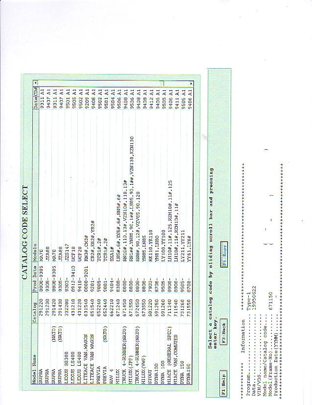

        Epc
        Hi JimL
        Had a look on EPC but can't identify exactly which Hilux model you have.
        Have attached EPC Hilux codes - if you can let me know from them exactly which is yours I will try to help. ( I am new to this EPC stuff)
        I have had a look through but didn't see a repair kit listed but all the seperate part numbers are listed - I can Email you the print-outs if you want
        Regards
        Silversurfer
        Nil Illigitimi Carborundum

            I've had a look at the EPC again and the piston seals don't seem to be listed seperately - you can only buy them from Toyota in the kit. It might be worth trying a local motor factors as I know that mine now recognise Jap imports and have the Surf listed for things like filters, etc.
            Roger
