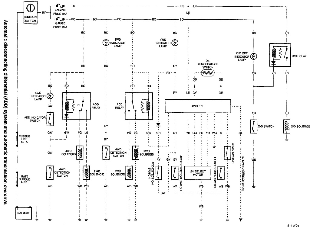

    Just wondered if anyone had a electric diagram of the 4WD set-up so I can see if me mate can find anything else?

    I've been strugling with the oposite problem, here's a link for a site wit a wiring diagram
    http://www.afm15.dial.pipex.com/surfpictures/Techy.htm
      Thanks,
      But mine is a manual, does this change much?
      Also where is the Relay?
      I know about the control unit, but can't find a relay
        The ADD relay is up under dash on the braket that supports the brake.There are two relays on this bracket and the brown one is for the aerial.
        This may help a well.
        http://www.off-road.com/toyota/tech/add/
