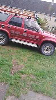

Hello guys, I'm new here, also new to Surfs. I have a Gen 2 and in based in the UK. Currently rebuilding these beauty. Can anyone help...
