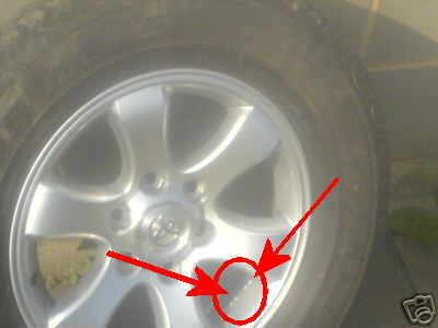

      seen these but seller cannt see any markings on them so would be a gamble i guess, as they look like the nut area is not inset as much as mine so would make them foul the inner wings i guess, so would have to cross your palms with gold for wheel spacers......

          isn't that the markings there?
            Them there is the balancing weights.
