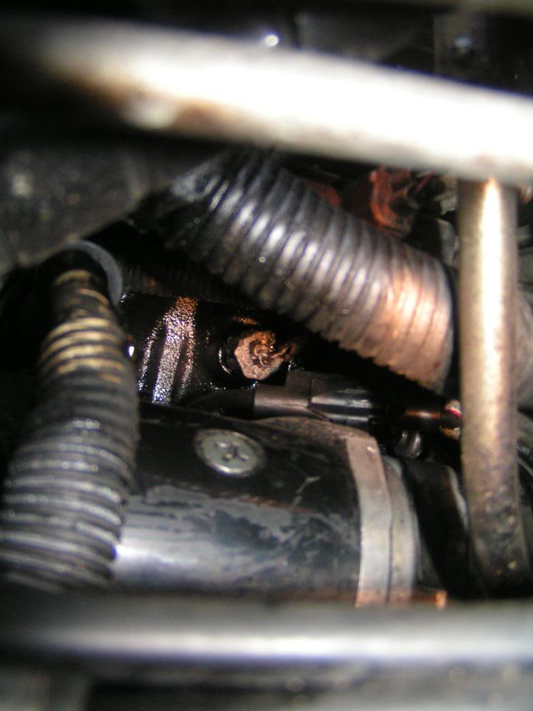

I got engine check light on (code 4), and when changing some coolant hoses, accidently punched the Fan Sensor Switch
Have to say I did try super glueing it back exactly where it snapped off but the fan don't kick in....

hi there, thanks for quick reply, i can't get the pictures from my phone to the pc, thinks its my phone.
The Rad fan sensor is the one on the thermostat housing, if your standing at the front of the truck its the one lower down closest to you.
Ok, the Temp Coolant Sensor is located just above and to slightly to the back of the starter motor, proper tw@ to get to reading some of the threads on this site.
Gimme half hour, am going to take some pics with my camera.
thanks
Hi again, coolant temp sensor is located just above the phillips screw on the starter motor on the pic to the left.
The Rad Fan Sensor is directly under the hose from thermostat housing at the front of the truck...hope this helps....
thanks for your time J
